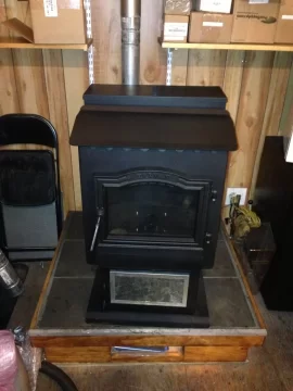

IMO, there are many benefits of a nice RAISED hearth in the basement.
1. Having it higher off a damp floor keeps paint from chipping or peeling
2. Safer, running into a raised hearth hurts less than a hot stove
3. Easier to pull up a chair and clean it out without stooping to low!
4. Looks nicer. See comparison pic below! ! ! Same stove, but a nice raised hearth makes it look better. LOL
Click pic of "Dueling Quads" below to Enlarge

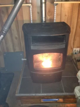

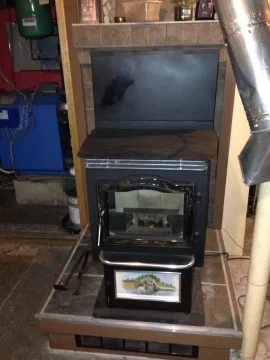

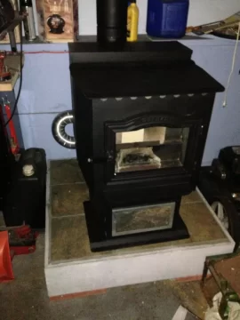

Would I benefit from putting the pellet stove on a hearth pad or would the difference be negligible?
Let's put this another way.
I would Never think of putting my Harmy's on a cold basement floor or garage floor or shed floor!
See pic of "My 3 Harmans" below. Click to Enlarge
Pic 1 - Basement
Pic 2 - Garage
Pic 3 - Shed
  • [Hearth.com] Adding a Pellet Stove to the Cellar
Pic 1 - Basement
Pic 2 - Garage
Pic 3 - Shed
