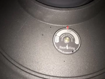

Here's the beauty of a BK. This is my Ashford 30 (just slightly smaller than the Princess) at 24 hours into a burn on a medium (2.0 on old numbers sticker) setting:

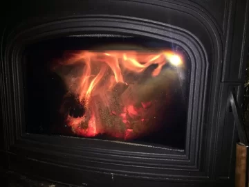

I turn up the air to see what's going inside, and instantly get this:
Again, in reference to rdust's comment on BK's burning low... this was on a medium setting (dial goes 1 to 3, I was burning at 2). I've not heard anyone bragging about 40 hour burn times from an IS, with the cat in the active zone the entire time, but I have no trouble hitting 36 hours these little Ashfords. I'd be amazed if I couldn't go 40 hours on a Princess and 50 hours on the King, with oak in the chamber.
I've burned a Princess for 5 seasons now and I can promise you it will NEVER burn 40 hours with any measurable heat coming off of it no matter the fuel type. I'm heating just shy of 2k in MI and I load twice a day when the real winter is here. The OP is in WI and wants to heat 2600, I stand by saying that's a stretch without supplementing it with another heat source.
The Ashford burns lower than the Princess.
Ashful are those times fans or no fans? Fans on low destroy my burn times.

I can get 36 hours out of the Ashford 30 with the fans on, at a setting of 1.8 or less. I think the fans really only affect the burn time by causing the thermostat to open a little earlier, but if you're really going for burn time and turning the stove down past where the t-stat is working (eg. 1 on the dial), then would the fans even have any effect? In other words, defeating the thermostat, how would blowing fans on the outside of a box affect the fire within?
I've only run the stove a few times with the fans turned off, and that photo of the cat probe above shows what happens. That was after 24 hours on setting 2.0 with fans off. If the fans had been on, it the needle would still be active, but only sitting around the 9 o'clock position on the dial instead of high noon. Again, setting 2.0 gives the t'stat a chance to work.
