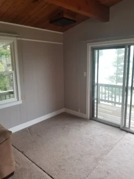

My wife and I just bought a Lake house that used to have a wood stove installed. The previous owners removed the wood stove and the hearth. I'm planning to build a new hearth and get a modern wood stove and chimney installed. I have several questions and it's hard to trust the fireplace installers because it seems like they are more intrested in sales then giving me good advice.
1. What should I use as a base to tile my hearth on? I have heard Durock and Micore 300. It will be on top of the plywood subfloor and covered in tile
2. I'm planning a Vermont Castings Encore or Intrped II. Are there any terrible problems with those stoves?
3. The wall behind the stove area contains wood paneling, glass patio doors, and vertical blinds. Any problems to consider if recommended clearances are complied with?
4. Any tile types to stay away from?
I have attached a picture of the area. You can see the seam of the carpet from where the old hearth pad used to be. It's roughly 6'x6'.

Looks like that was a corner install by the previous owner. Better choices out there than the VC units - personally I would give them a wide grith.

The hearth requirement will be determined by the stove. Some need only ember protection. For that case just Durock and tile is fine. Others need more insulation below the hearth and may need a layer of micore. The same goes for sizing the hearth. Any non-combustible tile is fine, but porcelain tile tends to be tougher.
