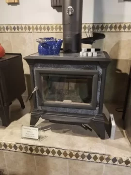

Update
I went to look at some non-VC stoves today. I was surprised to like the HearthStone Heritage so much. It is not what I was originally envisioning, but I like it. The Jotul F500 was nice as well.
Any opinions on the Heritage? Pros? Cons?

I have a heritage, starting the 2nd season with it, and quite happy with it. It's really pretty whether in burning season or not, heats great during 24/7 season (or straight through the weekends more likely for me). The weak point is that it takes a long time to heat up from a cold start, so not great for shoulder seasons if you want to get a cold house warmed up quickly. I really like having the side door, and basically never open the front door except to shovel out ashes (I don't use the ash door). It makes a great room centerpiece, as even when running flat out you can sit nearby without melting or needing to retreat to a cooler part of the house.

OP update.
After a lot of drama and research, I decided to go with a Hearthstone Heritage. I love the look of the soapstone and the reviews think for themselves. I'm planning to install a layer of durock above the subfloor and then a layer of porcelain tile. I checked the specs on the heritage and they seems to be no need for Micore 300.

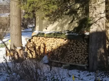

The installer is putting a new chimney with a double walled stovepipe off the stove. I have a wood cellar on the dry side of my house and started contacting wood suppliers in the area that have kiln dried stock available. Looks like $195 / face chord delivered. I cut some black cherry trees down this year. They should be seasoned in a year or two.
