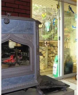

Not a good picture but this is one I took to show folks when I put a wood rack on the porch. We have a 16" raised hearth so we don't have to stoop to fill the firebox. We actually sit on a chair while loading. When the stove needs wood, we just walk out on the porch and grab 3 or 4 splits. Quick and easy and this way we do not have to store wood inside the house which is something we really do not like to do. Oh, and yes, the wood rack has been painted since this picture was taken.
Great pic
