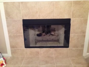

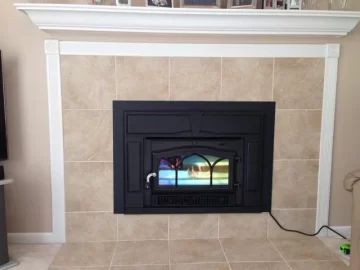

Can you compress a flexible liner enough to pull the stove out? Here is what I have from the outside. I am tempted to rip it all out, but I have a lot invested in this setup.

If clearances are tight it can be challenge. From the description I think I would leave it alone.
Yeah, the surround does come off pretty easy. I tried to stuff some insulation around the liner where it enters the chimney. It was too tight to even get much of that done.
