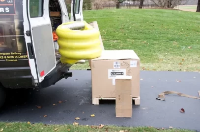

Hello,
I recently purchased a regency hi400 and had it installed in early December (it was installed by the folks at shop where I bought the stove, and they're certified). My chimney is approximately 30' on the side of the house, and before having the regency installed the fireplace was just open.
I think by default, the installers will use pink insulation at the top of the chimney and at the bottom, but not in between unless they see that the tiles were compromised. Even before they checked I opted to have the liner insulated at a cost of a few hundred dollars (let's just say 300-400). At the time of purchase it was explained to me that the liner would be wrapped in insulation, with a wire mesh of some sort wrapped around the insulation to hold it in place.

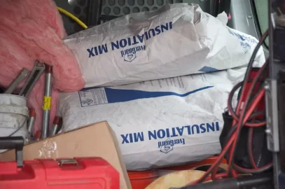

The install went well, but I noted that rather than wrapping the liner, they put the pink insulation in the bottom then poured what I'm guessing is a vermiculite-based insulation (thermix or some such), then I guess they put the pink insulation at the top too. Aside from not being what I expected I don't know that I have an opinion.
Now let me just say that I'm not interested in vendor-bashing at all, and I'm not here to complain or vent in any way. I'm ONLY interested in ending up with a good installation that I can forget about for a long time. With that said, after a short period of time I noticed that when I turned the blower fan on in the stove it blew out some of the thermix insulation (looks like kitty litter). it blew it out at a slow but constant pace with maybe a few tablespoons to 1/8th of a cup landing on my floor each day.
I called the vendor and they promptly came out and stuffed more pink insulation up from the bottom. I gave that a week or two but the problem persisted. I called the vendor and they promptly came out and stuffed more pink insulation up from the bottom. I gave that a week or two but the problem persisted. I'd have to check my notes because now I'm second-guessing whether they came to correct the issue just twice or three times before yesterday, but nonetheless, yesterday they laid out two options for me:
(1) they can remove the thermix insulation altogether and clean it up so I won't have the problem anymore
or
(2) they will remove the insulation, remove the liner, and install a pre-insulated oval liner instead
If I opt for #1 they'll refund the money I paid for the insulation while if I opt for #2 they won't charge me for the more expensive liner (or refund anything).
Again, I don't care to complain or vendor-bash, but what's the right thing to do with regards to ending up with a good installation?

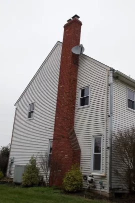

I live in southeast PA where it can get pretty chilly at times, for whatever that's worth.
I'll try to upload some photos to give you an idea of the install:

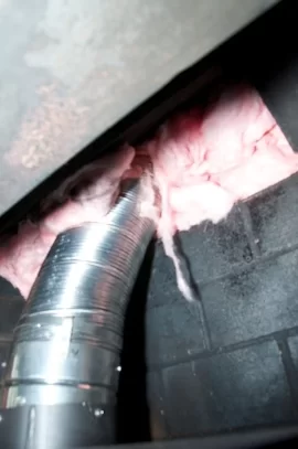

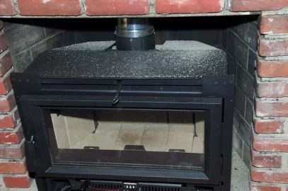

Seems like the easiest thing to do at this point is to install a proper damper sealing block-off plate. Stuffing fiberglass up there is not an adequate solution.
That's right. A block off plate is all that's needed to fix the issue.
That being said, I would never pour insulation in on an insert installation. For the reason you mentioned, it's a mess! If there is even a slight gap or hole it will continually fall out. And, to me it's too permanent. If you want to restore the fireplace at some point you've got a big mess on your hands! Wrapping it is so much better.
I assume they weren't able to fit a 6" liner down the flue with the wrap? And that's the reason for the ovalized liner?
Honestly it doesnt look like they even cleaned the smoke chamber out before installing the liner. Due to that and other problems i see with their install i would have them pull out everything but the insert and have someone else clean the entire system and properly install an insulated liner. And i agree with webby we almost never use pour in with an insert for this reason
Not to sound like a worrier but why would they use pink insulation, regular fiberglass that close to the stove and around the liner is a no no, if im mistaken, the pink insulation is flammable (if its what I'm thinking it can only withstand temps of up to 1,000 deg f, a chimney fire can burn +1500deg f)

I concur on the block off plate. It would clearly be the least labor intensive option and you would want a block off plate with that outdoor chimney even if you had an insulated oval liner installed. You don't want all your heat escaping up your chimney heating all those cold bricks! Tell them if they will put a block off plate down below and seal it properly you'll let them off on the cheap.
If they had cleaned it first i would totally agree after they pull out the fiberglass and re[place it with an appropriate insulation. But the fact that they did not clean it first is a big problem.
Ya I would definitely be nervous with pink fibreglass touching a liner like that. Here by code only roxul would be allowed in that type of application. I know for a fact thats what they used on my installation where the class A penetrated through the old chimney and class A stays a hell of a lot cooler than a flexible liner.

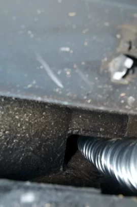

Another thing I noticed over the weekend was that not only has insulation been blowing into my family room, but it's also inside my firebox because I can't even see the cat anymore (the holes in the metal plate in front of the cat are full of insulation)
That means that there is a bad connection there somewhere. It needs to be fixed When you say certified what organization are they certified through? If it is csia you should report them installs like that make the rest of us look bad and it pisses me off
