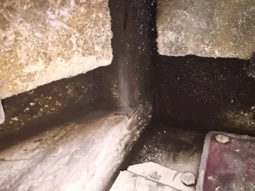

From the looks of that firebox it didn't fix the overfiring issue :)
yes or it is being run incorrectly or the damage was done before the plate was installed from all reports i have heard the restrictor works
I agree that the restrictor works, and i don't mean to sound like I'm saying I didn't make mistakes, but when I said I burn with it half-damped that's with the restrictor plate installed. Before it was installed even fully-damped was a crazy-fast burn (active yellow flames, not blue and lazy)

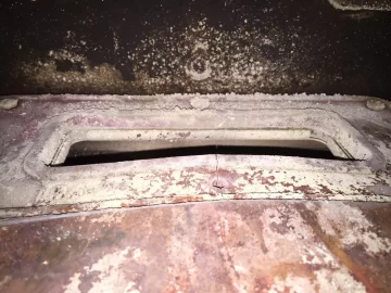

Here are better shots of the two cracks I found [so far]. That's funny; both pics are appearing upside-down for some reason. Sorry about that.

  • [Hearth.com] Advice on Correcting Installation (insulated liner)
I think it is a piss poor design myself, the cat is quite fragile and this whole slapstick mess of throwing a tube in to clean up the exhaust has not been properly thought out with this insert. If I had bought this thing I would block the air to that secondary air tube, or at least greatly restrict it (another restrictor plate).
