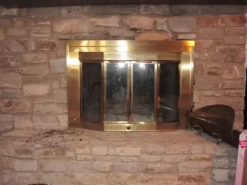

My husband and I are looking into purchasing a wood-burning insert. We've been reading through a number of threads, have spoken to a couple of dealers and looked at a number of sales websites. However, we are still confused as to which insert is best for our purposes. Any advice would be welcome. We are in San Antonio, Texas, so our winters aren't exactly like y'all's up north and temperatures fluctuate widely.
Our home is a 2700 sq ft single story ranch built in 1967. It has a moderately open floor plan with a large living room separating the kitchen/dining room from the living spaces (which are off a long hallway). The fireplace is located to one side of the living room.
The dimensions of the opening are:
Front width: 36"
Back width: 30"
Height: 28.5"
Depth: 23"
The chimney is 16' from the ground to the top of the masonry. There are no angles or bends in the chimney.
We would like to have the insert provide all or most of the heat to the house. (Our ancient furnace is not safe to run at this time). We are not home to fire-tend intensively, so longer burn times would be good.

Welcome to the forum!
Given your more modest heating needs a catalytic insert would probably be a good option. Catalytic stoves allow a more controlled burn as well as low and steady heat output with the ability to crank it up when needed. They will also give you longer burn times. Unfortunately, there are not many cat inserts on the market. In terms of technology, the BlazeKing Princess would be a good choice but it is not what I would call a good-looking insert. The Buck 80 would maybe be another option. How deep is the hearth? Maybe you can fit a Woodstock Progess Hybrid stove in front of the fireplace.
From your list I would be a little cautious with the HI400. It is a new unit and Regency may need to work out some kinks before it will live up to its billing. Here is an extensive thread about it: https://www.hearth.com/talk/threads...y-ci2600-fireplace-insert-risky-costly.132252
I would add to your list the Enviro 1700 insert, probably the Boston model. With its 2.5 cu ft firebox size it should fit your needs and have the look you seem to prefer.
Have you thought about a pellet insert? They will give you thermostat-controlled heat and much longer burn times than most stoves can provide.
Now a few caveats:
It sounds like the insert would be on one end of the house. Stoves are space heaters and you may have difficulties to get the warm air to travel to the other end of the house. There are tricks like strategic placements of fans but 2700 sqft on one level will likely be a challenge.
Most inserts/stoves require at least 15 ft of chimney; that's just about what you have. During milder days you may have draft problems. Extending the liner with a few feet of class A pipe may become a necessity should that indeed happen.
With an exterior chimney an insulated liner is pretty much required. What are the inner chimney dimensions?
All modern stoves/inserts need dry wood with less than 20% internal moisture to perform well. How long has your wood been split and stacked?
To keep the heat in it is highly recommended to install a block-off plate: https://www.hearth.com/talk/wiki/make-a-damper-sealing-block-off-plate/
And insulating the fireplace may also be a good idea: https://www.hearth.com/talk/threads/finally-got-around-to-insulating-my-fireplace.75755/
That's a pretty roomy fireplace, should be able to fit most inserts, or some free-standing rear-vented stoves as well. In that climate, I'd go with a catalytic combustor stove so you can burn at low, even output and not roast yourselves out of the house. With a non-cat you will have to burn small fires and re-load more often if outside temps are moderate. Not sure how well the houses of that vintage are insulated down there, so maybe you would be burning hotter than I'm guessing you would...
As far as cost, that estimate doesn't sound excessively high, but others will have a better idea. If stainless chimney liner to the top is in the estimate, that can be expensive depending on the quality of the liner, weather a block-off plate is installed, etc. Installation is possible to do yourself if you are reasonably handy and detail-oriented, which would cut costs. Sounds pretty straightforward, with the straight shot up that you describe.
I agree that regular woodstove would be mostly a pain in the butt in your climate. You would basically be burning in what we would call shoulder season all winter long. That's when we use the furnace purposefully just to give it some exercise.
