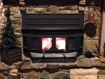

Install going down the next couple days anyone have some experience removing inserts? Trying minimize damage to my stove hearth

Really don't want to damage the stones. All we have is a dolly and rachet straps it's going to be rough the hearth is around a ft tall plus I have tile work extending out infront that's about 2.5 ft out
2 young guys lifting but do not want to throw my back out . Got a guy at work who dead lifts over 700 lbs should just rig something up and have him do it haha
I would take a stack 2x4s and make a Jenga like cribbing in front of and level with the hearth. Leave enough room on sides for a bottle jack. Lift the stove enough in the front to get a sheet of 1/4 plywood and some 1/2" conduit or bar under it. Roll it out onto the cribbing. Once on the cribbing you should be able to jack up one side at a time and remove boards until you can get in on the floor. Make sure the cribbing is latticed and not a stack on each side as that will not be stable.

First remove the firebrick and the door, etc. Then I did the same sheet metal idea. I also put cinder blocks under the steel past the hearth to help protect the edge. I then moved the stove out onto the cider blocks and used a floor jack to lower the insert down and roll it out to get a hand truck under it and then out the door it went.

Good luck with your install, that's a good lookin fireplace, gonna be right purty with that new Englander sittin there, fire in it's belly!
Go egyptian. Lift the sotve up slightyl and insert rollers underneath.Roll it to the edge of the mantle on round steel pipes or wood, Place it on the dolly this should be to only time you need to use brute force.
