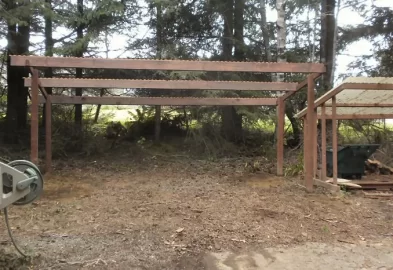

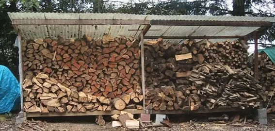

I'm building an additional shed, simpler in design than my current shed:
[Hearth.com] Advice on Shed Roof Joinery
I will sink four 10 foot 4x4 posts about four feet into the ground. The front will be about 16 feet wide. The roof frame will have 16 foot 2x6s across the front and back, with 2x4s on the sides.

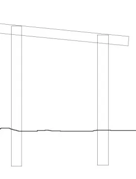

The side will look like this:

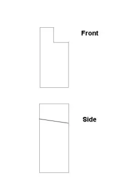

And my question is, should I just screw the 2x4s in the roof frame to the posts, or cut out a rabbet into the top of the 4x4 posts, like this:

Just screw them to the 4 x 4's they will hold just fine. Also, no need to go that deep 30in is plenty deep. If you have a normal set of post hole diggers like me and not a digging set you will never get 4 ft anyways unless your hole is pretty big in circumference. But, it's yours shed go overkill if you like!
Also, I wouldn't span over 8ft with your header or you will get sag overtime.

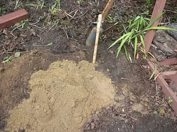

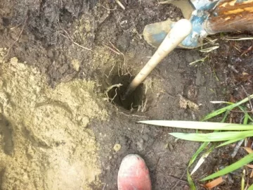

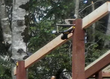

Overkill is what I do! I actually did get to four feet, but I see what you mean -- the post hole digger handles couldn't get very far apart at that depth. The sandy soil at that depth helped.

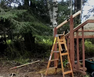

And I couldn't resist putting a little groove in there to support the side beams. That 2x4 is just for alignment purposes.
Two down, two posts to go. It looks like this is going to work.

rabbeting your posts is never a bad thing.... I have no knowledge of your winter climate... but I do know, unless your old shed was made of fir or better, it wouldn't make it through one winter here....

You don't want to span 16' with 2x6's. It will sag very quickly and have a lot of lateral play too. Make it 6 posts and you're in business.
Since you've already notched 1 side of your 4x4's, attach the headers with some lag or carriage bolts. That needs to be strong because you are supporting your entire roof system with those few places you connect to the posts. Pole barn nails would work as well, but lag bolts would be much stronger and easier.

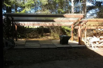

I'm ready to add the roof.
There's absolutely no sign of sagging in the 2x6s. All the posts go down four feet, and there's no sign of lateral play. This thing is solid. It's a much better design than that of the last shed (on the right).

Here's the joinery I used:

Nice work. In the process of building a shed for myself, so I am following this thread pretty closely. Can I ask how you notched out your posts? just plain old circular saw, or do you have sawzall? (I'm looking to do similar notching, and haven't figured out the best way to make the cuts. (I don't have a table saw)
I notched them .75 inches -- that is, half of the width of a 2x4. Yes, just a plain old circular saw.
Here it is with the floor:
It rained the other day, and I was noticing how far in the rain comes. I opted for a high shed, and like the open design, but the damp area on the ground is 1-2 feet in from the edges.
