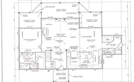

Thank you for the advice so far. On having one in the basement only, I really want a fire "place" on the main floor. I'm attaching my draft floorplan b/c the stairway is not central so the heat would not come up through there to the usable space. Soapstone heating up slowly shouldn't be too much of a deterrent b/c we will be home a lot so I would think we'd just keep it going. If we don't go soapstone, what material do you think is best: steel or cast iron? Again, we're new to all this but would really like a consistent warmth, not hot and cold swings.

Random thoughts:
-If you want even heat, a cat stove with thermostat works well. I'd say better than a soapstone stove, but I have no experience with those, so this is speculation based on the arrogant "it's not possible to improve on best"...
-Getting heat from the basement up through the stairs (if the basement stove would be at the black square) seems tough in your case as it'd need to go around a lot of corners to get to your living room. Moreover, you have a vaulted living room, meaning you'd need a lot of heat to heat the living room b/c a lot will go up. (Ceiling fans mitigate that a little bit - but it's not ideal.)
You also would need to provide a return for cold air to the basement stove - i.e. a second (big, 16") "hole in the floor" for optimal heat convection, creating a loop for the air to travel.
-I do not see your master bath going to get any heat here.
-I have not heard very good stories about moving heat around with a ducted fan system (that is used with a heat pump).
-A stove in the main living room (put at a place where the flue can go straight up inside) seems best. Get one with a big window for the flames. That'd provide heat for most of the time (when no guests, and working out does not need much heat...). If you want to shell out more $$ for a stove downstairs that you won't use much, that's of course fine.
-Cast iron or steel - I've had both. I don't think that should be a concern. For good stoves either way is good.
-If your home is new, and thus "tight", you may need an outside air kit; the stove uses air and sends it up the flue. That needs to be replenished by air coming in from outside. An (air)tight home might result in trouble there. So your stove *may* be best situated at an outside wall for the air connection.
-Check chimney height requirements for stoves you are interested in before you build...
-See if your builder can estimate the BTUs needed for your home (he'll be sizing the HVAC unit anyway, so he should know) - and compare to data on different stoves.
-I second the remark above: it's ideal if you can walk in with wood to the stove without too much of a trail of dirt winding through your home. The screened in deck could hold a rack, but is it above the patio? Stairs? (When getting older...)
