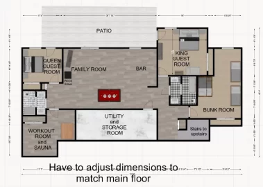

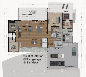

We want to do the wood stove on the main floor and maybe a less expensive one in the basement but maybe not...?? Where would you put ductless split in this floor plan and would we not need central heat/AC if we did that?
You have to have a local HVAC guy design your system, there are many factors, the basics are , SQFT , floor plan, insulation values, window and door locations Etc..Also, the split systems are two part systems, compressor needs to be located outside, the unit itself will get mounted to a wall, you want to avoid long runs of copper running long distances between the two parts..
Then there is the ducting, if you are going to use a single system and split zones, you must run ductwork to accomplish that..The floor plan you showed me would probably require 2 systems on each floor...

Your floorpan is similar to what we are currently building. I'll give you my thoughts as to why we designed and purchased what we did. I designed the house to be able to live on the main level and never go down to the walk out basement unless we wanted to. It has a very open public area on the main level and a master tucked away far from the stove. We will heat exclusively with wood but have a propane furnace as back up. Our previous house had a secondary burn style stove that needed reloading every four hours, was undersized for the house, and required building and lighting a new fire every morning which made getting out of bed uncomfortable. My stove requirements were to have a long burn and put out lots of heat. I went with Blaze King - King. The thermostat was the deciding factor over Woodstock. Aesthetics was far down the list but we both like the big black box stove style so it worked out nicely.
The basement has a couple of bedrooms and a large room for a pool table. We are putting a stove downstairs, BK - Princess, with the hope that we go downstairs more often if it is warm or that we can start a fire a few hours before heading down. The basement in the previous house was 38 degrees and unused all winter, seemed a waste.
My only concern is getting heat to our master bathroom. We have a second door on the backside so it creates a loop but will have to learn what happens once it is all built. Your set up is more challenging and might require a space heater or nice romantic gas stove by the bathtub.
