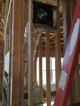

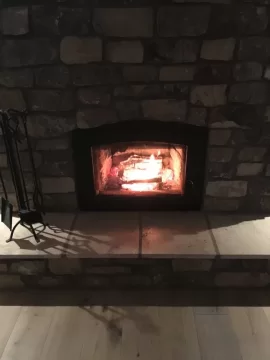

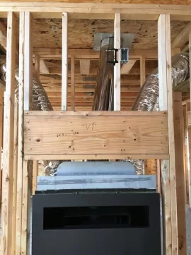

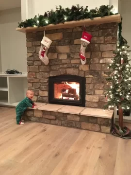

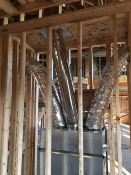

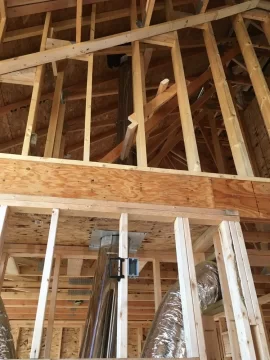

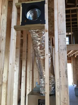

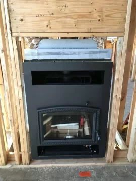

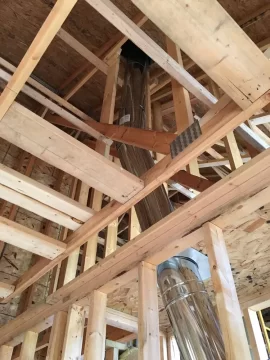

Mine was for a new construction and I was strongly considering the Napoleon or the Fireplace X models, I wasn't aware of any of the other possibilities. I ended up going with an RSF Opel 3C that got installed long before any drywall was ever put in place. My home works out to roughly 2900 sq. ft main floor and second floor. We chose to do a clean face install so no frontal venting. As such, we had to install gravity vent kits and I put an inline blower in to help move air. My only other heat source is geothermal and I have the electric backup heat breakers turned off. I do have in floor heat in my basement as well supplied by the geo system. Our first winter in the house, I freaked out over my electric bill from running the in floor heat, heat exchanger portion and allowing the backup resistance heat to take over. So I started burning more regularly (daily).
This unit does a great job heating my entire house. I have an open floor plan for the most part, my living room has cathedral ceilings that open up to the upstairs. My kids often have to sleep with their doors shut unless its really cold out. I did not chose to go with connection to the HVAC, it was advised against. I believe now, feeling the heat output from the gravity vents that was a mistake. If I were to do it over, I would not do the clean face install but would get the front venting and then tie in to the HVAC. That way the unit can still push heat into the room via natural convection in the event of a power outage, but otherwise proved heat to all areas of the house. I have not measured the heat out put from the heat exchanger but cant imagine that its much hotter than what I am getting from this unit. And the ambiance of the fireplace look is well worth it.
I have since modified my approach. I now have turned on the in floor heat and with the combination of that and the fireplace that actual heat pump for the forced air portion of the HVAC rarely runs (until the last couple of weeks). Even then, the system is well capable to keep up with the heat load. I did not do spray foam as my builder didn't believe in it and I have lots of big windows (Marvin Integrity Ultrex all fiberglass) so there is opportunity for heat loss. Now, do I think that I am getting the same benefits as a big wood stove, probably not. I recognize that a monster Blaze King, Kuma, or any other 3.5+ cu. ft. stove will likely put out more heat to the room more efficiently. But there is something to be said about the look of the fireplace and most importantly, a happy wife.
