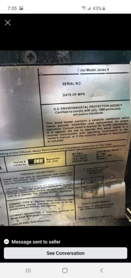

I am new to stoves but looking to buy a used stove to place in a new build cabin. I believe it is a Jotul Series 8 based on the appearance and tag on back. See photos. I noticed there is an option to vent out the top. Is there a special piece required to cover the vent that is coming out the back? Or can the round cap just be moved from the top to the back vent? And are fire bricks required for this model? Or any other things to look for before buying?

The flue outlet on the back is reversible, but the stove does not vent out the top. This most likely is a catalytic stove. In addition to general condition and no cracks, you'll want to know the condition of the bypass, burnplates, fireback and catalyst assembly.

Thanks. What is that round hole/plug on the top, as seen in the picture? And for the bypass, burnplate, firebrick and catalyst, what would those items look like if they were in fair or poor condition?
I'm no expert but I've had the same stove for 25 years, great stove. Based on the label plate stating it's a catalytic, it's probably the Series 8 AP. The round hole at the top is, I believe, simply there to replace if it wears out. It's the top of the stove so that piece gets quite hot... after 24 years I replaced mine... IIRC due to it becoming a bit thin, or maybe the edges were starting to recede a bit... but it definitely had a funky gasket that didn't seal anymore due to the wear on the part. There are no firebricks, there are burn plates (essentially steel plates on the walls of the stove) to protect the outer walls.
Lift the top of the stove off (no bolts, just lift) and operate the bypass damper on the top left. you'll see the damper open and close. inspect that bypass damper for signs of "melting", like a corner that isn't there, cracks, or anything that doesn't allow a good seal... but the gasket can be easily replaced if that's the only problem with the seal. Look inside at the plates on the 2 walls for cracks or melted areas. For example, I can see in your photos that the back burn plate has melted away, that's the part inside on the bottom of the back wall, leaving jagged edges on the plate. See my post this morning and that's what it's supposed to look like. Mine has done that twice, although I never overfire it, and I'm not sure exaclty why or what the permanent fix is, but based solely on my experience I'm guessing it's not uncommon. It's a relatively easy fix if nothing is rusted too badly.
I don't see an ashpan. It there's none, it's just a series 8. The top round plate is the cook plate I think.
