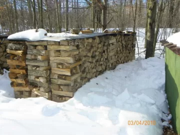

Dan, you have learned like the rest of us. Wind and air circulation are the key factors in drying wood. We've stacked in the shade many times and had no problems. We have also stacked in the big stacks like yours and had no problem. Mostly though, we stack like this:
[Hearth.com] Advise on what order to burn my wood in this season
Stacks are 4 1/2' high when green. Many think that center row won't dry as well. If that were the case they would end up with the outer 2 rows lower than the center row. That does not happen. We usually have it stacked by April but leave it uncovered until early winter.
That is exactly how most of my stacks are. I have to large square stacks, but that was a room issue at the time. I wont do it again tho.
