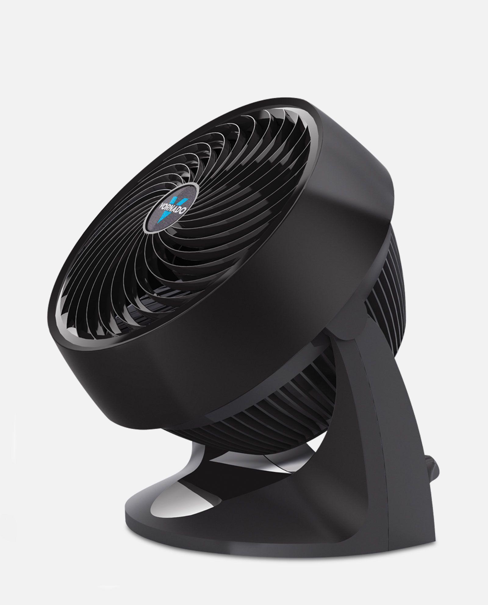

I have been using regular fans and ceiling fans to move the air for a long time. I have known about Vornado fans for a while but didn't want to spend the $$ on one.
I finally broke down and got one from Lowes this weekend so I could return it if I didn't like it after reading posts about it.
All I have to say is, WOW. I got the 533 because that was what was in stock but it is actually the perfect size for my setup, this thing MOVES some hot air. I was using fans to blow cold air into the room with the pellet stove but now I am using the Vornado to push the hot air out into the rest of the house and it has been a game changer. I could only get the hallway on the other side of the rancher to 70-72 degrees. On Saturday with it being in the teens outside I had it 76 degrees! No other changes other than turning off the ceiling fans and all the other fans and using the vornado to blow out the heat.
I should have done it sooner.

Where do you have the fan mounted/sitting?

I tried it blowing cold air in like previous fans and it did OK. I figured for kicks and giggles I would try putting it up high in the same room as the stove and point it towards the door I want to blow the hot air towards.
I currently have it sitting on top of a bookshelf so it is about 2-3ft from the ceiling with a book under the back so it angles down more. I have a corner install pellet stove so the hot air from it is being blown out that door now.
I have a rancher so the bedrooms are on the other side of the house (1600 sq ft house) but it is a straight shot from that door, I can now stand in my bedroom with the door open and feel the heat coming in, I was not expecting that.

Interesting. I may have to try this. My house is a ranch that is shaped like an "L". I have a pellet stove at each end with box fans blowing at them. Works decent, but not great.
How quite is it on low?
yes the vornado, looking for a small super quite fan. i know those vornado fans used to be excellent. Glad to hear they still seem good.
