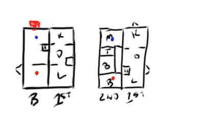

following likewise. having some difficulty getting the warm air circulated at the house. the house is 2 stories i the back with 1 in the front. the bedroom is directly over the stove, so to keep the bedroom not too hot the idea is a cycle pulling hot air up through the far bedroom and back down through the master, with floor vents. hoping to find vent fans that can switch between pull and push air flow directions. any seasoned folks have a tip or two?
here's a sketch of layout. blue - cool down, red - warm up

Are there fans or blowers you can install inside of duct work?
