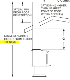

The stove needs good suction (draft) in order to pull in enough air for the fire. I'm wondering if you need more pipe to improve draft. You're in a very mild/ warm climate that can further spoil draft. Describe in detail the entire flue system including elbows, pipe diameter, height, etc.. How tall is the flue system on this stove from stove top to chimney cap?

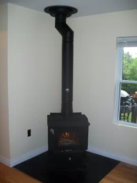

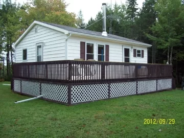

I have the same stove (Century Heating 2470) and it can be fussy, though the phrase "you get what you pay for" has proven itself correct since making the purchase. When first installed there was only 6' of insulated chimney plus 7 feet of stove pipe, including 2 45 degree elbows - smoke and sputtered no matter what you did when trying to keep a wood fire going. Had the installer come back and add 3 more feet of flue (and roof braces) and the problems pretty much disappeared. He claimed the original install burned property when he tested it, using a load of corrugated cardboard!
The air control rod connects to the damper under the pedestal, you can reach in and make sure it's attached correctly. The baffle bricks can't block anything as the smokes exits just behind the door and rolls above the metal baffle. As for secondaries - its a piss poor design that doesn't do much more than cause the flames to roll around more with the air coming in.
I've attached pics showing my installation.

Thank you everyone, especially Jean-Claude. I never thought of the chimney not being tall enough. I can't measure right now but I'd guess the chimney is 7' and then another 3' out the roof (on second story and in corner of house so not much attic). Also, was able to cross reference century 2470 and get more info. Thanks again!
If you have a total of 10ft of stack, I think you may have just found the problem. Too short.
If he doesn't I will. That stove wants 15ft minimum chimney.
