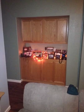

Here is a photo of the alcove. BK's requirements are much less stringent than Lopi's for alcoves too.
I'm going to pull these cabinets and push the wall back for more room from 24" to 36". There's a closet directly on the other side of this alcove with 36" of depth to it.
That truss is just to the right of the center of the cabinets which is the center line for the alcove. I still think the BK Sirocco will be fine with no elbows though.
What do you guys think of this spot, looks feasible right?

Yes, the Sirocco and Ashford have easier alcove requirements. If its flue location is also better to avoid the offset, it sounds like a winner.

Would it work to simply off set the entire stove in the alcove and then "balance" (frame in one side slightly more) the opening back out so that it appears centered in the opening. This is what we did to accommodate the water heater vent.
What is on the closet side of the alcove. bedroom? If you move the wall back will you still keep the closet? Reason i ask is that if its a living room or such you could eliminate the alcove entirely and open it up on both sides. With out knowing your floor plan I'm just rambling here.
The room I'd be taking the foot from is an office with a 36" deep closet right now. If I take a foot from it it will still be big enough to hang clothes and store things in, just not as deep.
The Sirocco I think will fit just fine in the alcove and I don't think I'll need to use and concrete board or rock since I'm going to go double wall pipe, the fans, and get the rear heat shield. The BK manual doesn't say I need any more than that for the clearances I have.
I will have to very slightly off set it to avoid the truss but only and inch or two if I have done my math right. If not I think I could use two 15 degree elbows to center the stove and maneuver around the truss in that false ceiling area. Duratech chimney pipe has 15 degree elbows and 30 degree elbows I can use, they are not cheap though....
