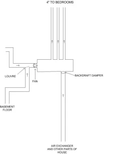

My question is about heat in the bedrooms. My goal here is that when the wood stove is in use, I would like the heat to be distributed enough that I will not need to run my upper floor heat loops.
So here's my plan.
I would like to add some 6" ductwork on seperate fan that will pull warm air from behind the stove and exhaust it into the bedrooms. This will serve the dual purpose of blowing cool air off the basement floor in the summer time with the addition of louvre. The ducting from the 3 bedrooms will tie into a seperate header witch will tie into the air exchanger and the fan. I attached a quick sketch.
The air exchanger and the circulation fan will be electrically interlocked so only one can run at a time. The air exchanger I have does not have a circulation feature, but the programmable controller does, so I will install the control relays off of that so they will play nice together.

At this point the ducts are just stubbed into the basement and the air exchanger is sitting at the suppliers waiting for me to pick it up, its not a lot of extra work to do the ductwork this way instead of a traditional system but is added time and money.
Does anyone have a similiar set up and how does it work for you? Thanks

If the entire ducting system and air handler is within the insulated envelope of the home it could be considered. If not, forget the idea. The heat loss to the uninsulated area (even with insulated ducting) is greater than you think. plus all the connections are never 100% sealed.

Others will weigh in, but venting FROM the perimeter areas to the stove area maybe more desirable.
The ductwork is all inside the house, runs are probably 25' each or so. I never really gave the carbon monoxide issue much thought. The combustion air for the stove will be directly piped from outside, but i'm not not sure if that matters.
Simplify this to one insulated run from the bedroom area to the stove room. Pull air from the br area and push it to the stove room. Warm air will replace the displaced cool air.

Reversing the air direction would not be a huge deal I think, could actually save me from having to install the ductwork behind the stove, as I could tie into the kitchen and dump the cold air there.
