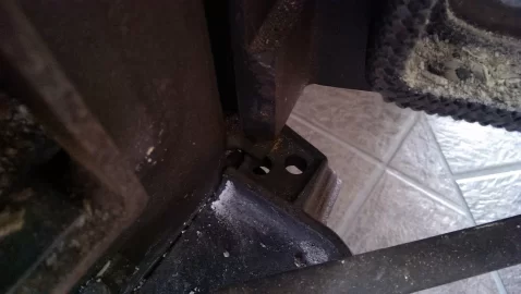

Hi, I have trouble to find out how to adjust the door of my stove. I will include pictures maybe it makes sends to somebody. The picture is from the top of the door but there is a same set up on the bottom of the door. Thanks for the help

What are we looking at in the first picture? I'm not seeing this on my stove. Have you contacted PE tech support and asked them for assistance?
yes I have and still waiting
In the far right corner that is the pin from the door but what the 2 in front of the pin are I have no clue
Curious I don't see that on our stove. Your stove is one of the earliest off the line. I wonder if the allen screws are an adjustment? Are we looking at the bottom hinge pin here?
No..That is the top but it is the same as on the bottom. I talked to madison and he said he had hinges and his stove is from 2006 mine is 2007
Are you sure you have the dates correct? Madison got his stove in Sept 2008. I got mine in March 2008, though it was a showroom model from the Chimneysweep, so a fall 2007 model. I'm thinking you may have an early 2007 model and possibly one of the first off the line. The hinge pin definitely doesn't match mine. Those allen screws are not present at the top or bottom.

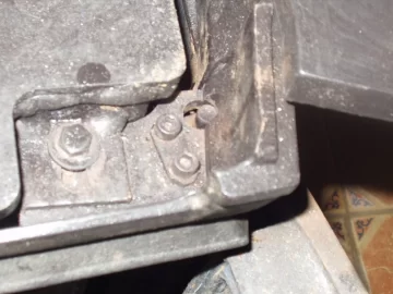

This is what our hinge base looks like.
[Hearth.com] Alderlea T6 door adjustment
That looks different. I think I found out how to adjust the door. I took of the right leg to get to the bottom allen screws loosen the top and bottom allen screws. I can move the door in place maybe not perfect but better than it was before but to be sure I have to wait till my girlfriend comes home I need a extra pair of hands. Somebody needs to hold the door while the other tighten the allen screws.
That's what those screws looked like they were for. Good to hear you are making progress.
