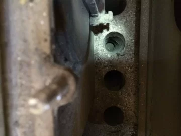

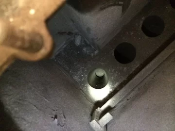

Cleaned my tubes the other day. Probably around 4 cord burnt since last cleaning.
  • [Hearth.com] All clean
Are you using chains or the spiral turbs? Thinking about switching over to chains.
JT, didn't you buy some round wire brushes to attach to a drill?
Im using the spiral pieces that came with it. I unhooked the linkage to the handle to make them easy to take out. that handle dont do much anyhow.
I did buy a brush for it, but i didnt put it in a drill. I just ran it up and down a few times. It fit very tight, but not to tight. maybe I will try a drill next time
