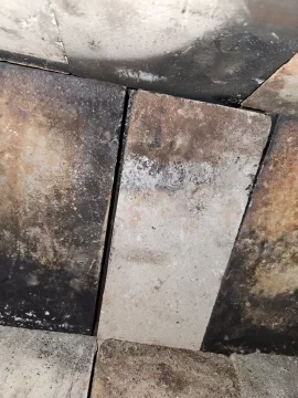

Hi all i cleaned my stove last night and when I got done I noticed a gap in the bricks in the back wall. One spot it around a 1/4 to 3/8 wide. Is it ok to run or do I need a new brick

That looks ok, typically they fill gaps with ash buildup anyway.
