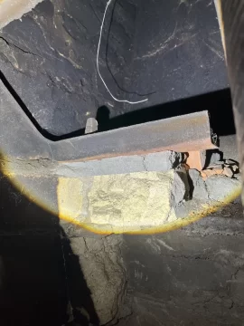

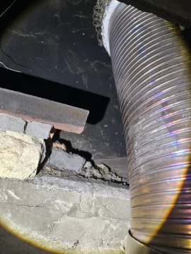

So here are some pics of the back of the masonry firebox. The back firebricks had been altered to allow for insert to fit. I would be installing block off plate against the currently rough lighter colored masonry. The block off plate would be below where the installer had cut back part of masonry and damper. I will apply mortar to the rough masonry to try to get as smooth a surface as possible. The back corners are uneven- the old installer did not chisel anything out on the sides of firebox. I think I will have my work cut out for me with accommodating the rough and uneven parts when fitting the block off plate.

If you’re using regular mortar, say type S and can’t get it to stick, making it into a slurry and painting the slurry onto the rough stuff can help. A chip brush will work for this. It doesn’t need to be a fancy brush. Like sticks to like. Also, driving in tap cons where the head isn’t seated will give the mortar something to hold onto in addition to the old brickworks.
From the pics I put up, wondering if i fit the blockoff plate as well as possible on the current rough masonry surface on the back of upper firebox and then jammed in gasket material in the gaps would be ok. It’s already going to be a bit of a project dealing with cutting out damper frame. Looking for anyway to cut down on time, but still have it be a good blockoff plate.
Obviously the smoother and more tight fitting the plate and masonry are the better, but any plate you put in there, and any extra (non flammable) insulation you can stuff up there is going to make the situation better.
If it’s not perfect I think it’ll still give a noticeable improvement. You’re still reducing the opening up the chimney.

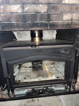

Another question guys- I would like to attach the front part of the block off plate to the underside of the first course of bricks going across the front of fireplace. These are held in place with an angle iron. I want to see if there was a recommended way of attaching block off plate to the underside of the angle iron. Thank you!
How tight is the angle to the brick? Could the sheet metal fit between the angle and the brick? A good bit can drill into the angle. You could attach right to the angle. I’d probably pre drill then run a screw into the angle. I’m not sure if that’s a preferred way, just how I’d tackle it. Maybe use a brake to make a nice finished edge so it looks nice for the next yahoo that gets up into the fireplace!
Thanks for the info-I’ll look at the angle iron better to see if there is any ability to put sheet metal into that space. I included a pic for reference. You can also get an idea of the back wall of firebrick having been altered by previous installer. Rough but I think I’ll go for it with attaching the block off plate to it and then adding gasket to any small gaps. Was thinking of stuffing gasket into any gaps and then putting high heat RTV silicone on as well to help seal gaps up. As it turn out the back corner of the firebox will probably be the challenge with the uneven corners/
Thanks for the info on possiby attaching right to angle.
I may get myself a cheap sheet metal brake. Future yahoos are on their own but it sound like it would be helpful in make good right angles.

If you need to, you can use a couple pieces of angle iron to pinch the sheet metal and then either lightly turn the edge with a hammer and block of wood.
