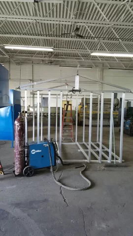

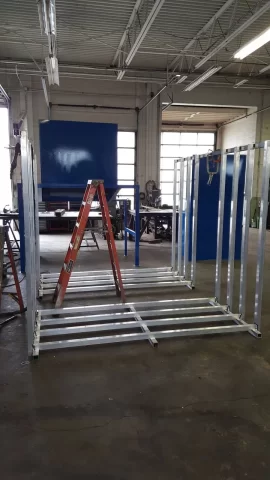

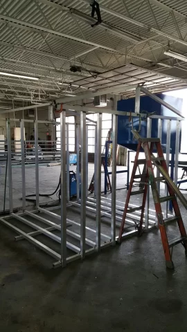

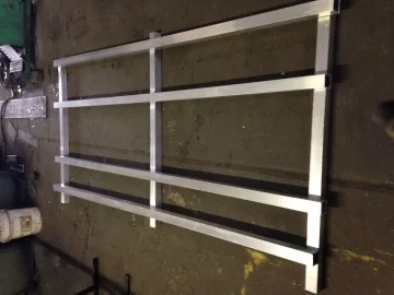

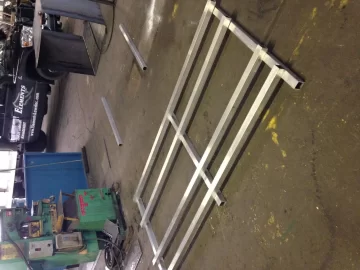

In the process of fabricating an aluminum wood rack. Finished dimensions will be 8' x 10' with 84" + height.
All 2" square aluminum tubing. Hoping to fit 4 cord
  • [Hearth.com] Aluminum Wood Rack

When finished it will have a tin roof. Not meant for carting around. I run a custom fab shop if you have something in mind to build I will be glad to help out.
what's your method of attachment for the frame work? Welded or bolted together?

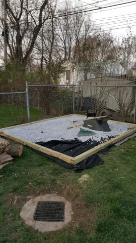

Nice base of gravel.
I magnified it and it looks welded. There is a picture of a miller tig.
Approx how much would you charge for something like that? There's a fabrication shop down the road from me here, I've been thinking about asking them to make something similar, but I don't know what type of pricing to expect.
The frame is made in two sections that will bolt together at the middle of the "A". The tubing is all MIG welded.
Reactions: Mag Craft
I have used about 14 lengths of 2" x 2" x 1/8" wall aluminum tubing 24' each length. My costs on the materials is about $800.00
So you Mig welded the aluminum. I just assumed it was a Tig. My bad.

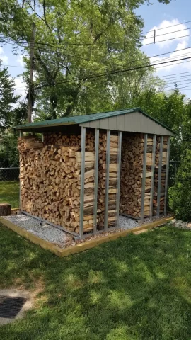

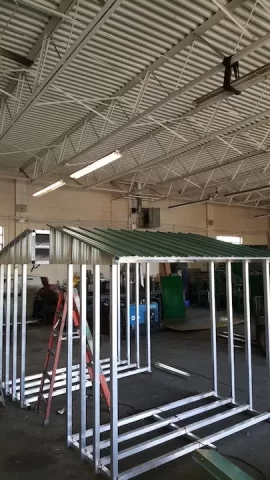

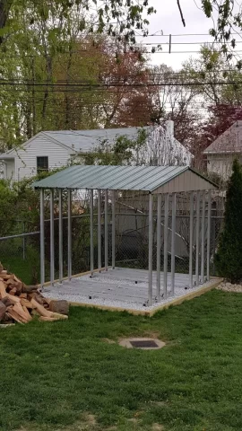

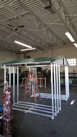

Progress slowed down the last few days but here is a close to complete aluminum wood rack/shed. Built in 2 pieces for transport and will bolt together in the middle.
Reactions: Soundchasm
Nice shed/rack. Its a rack for tax purposes. I would make sure you isolate the aluminum from the PT sills.
