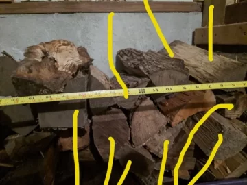

very good question. i think i see what youre asking. maybe theyre too small? moisture reads at 12% on the surface.. so maybe too try too??

this wood is older. i just went outside and split one. inside moisture reading 17%. so im thinking maybe my pieces are too small and possible too dry.
im assuming the way to do it is to burn much larger pieces at night; less surface area?
How big are your splits?

very good question. i think i see what youre asking. maybe theyre too small? moisture reads at 12% on the surface 17% on the inside.. so maybe too dry too??
They are not to dry at 17% unless they are kiln dried there is no way to get wood to dry in our climate especially this year. And i split much smaller than what i see there. It looks fine. You will get the hang of it.

Maybe I'm getting old or I'm missing something from the pic with the tape measure. I didn't see 1 split larger then 4" across the widest section of the split. Seems rather small to me. Could be the angle of the tape measure also ,who knows . good post though.
I spy Tulip Poplar in the upper right... great shoulder season wood but it burns super fast just like pine...
It also looks like your splits are pretty small, so your 40 splits would be most peoples 20 splits.

Yellow lines are going to pieces I feel confident in them being tulip poplar, though I could be wrong. Ive burned a lot of it, and its a good early season wood but performance isnt on par with classic hardwoods to get 8-12hr heating times.

I think 40 pieces is a little too much. That being said you have small splits looks like you're averaging 3" across. Are you letting the stove go down to coals or just stocking it up as you have room in the firebox? Also if you are burning softer wood you will go through more.
