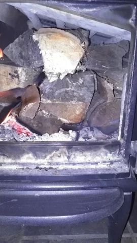

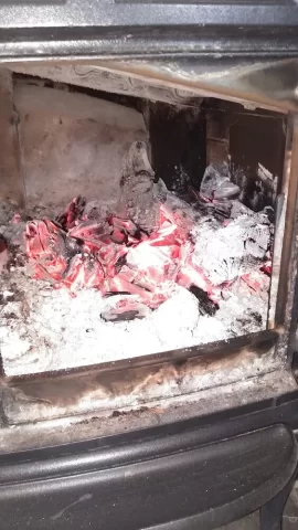

Where was the air and damper set at?So this am i posted a picture of a load i put in the stove before i left my house that was at 7:45 I just got home and this is what i have its now 12:10

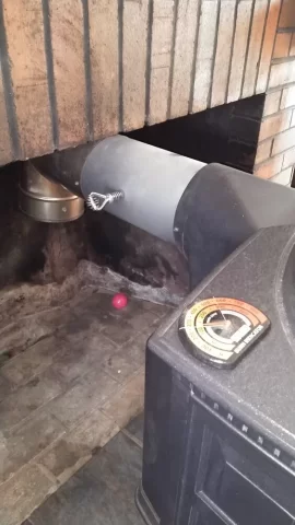

Ok so put the thermometer on the pipe just past the damperIm vented thru a masonry chimney with a 6 inch liner I cant go up that high ill attach a picture
Ok for best efficency you should run about 250 there or a little more. But run it up to the top of the middle range to start. You will probably have to start shutting back before you hit that thoughIts there ill let you know firing up now

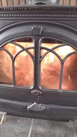

Check for leaks first. Your chimney isn't all that high it would surprise me if you needed a second damperJust came in from plowing the driveway very lazy burn going pipe surface temp is 380 ish I noticed from left of the stove the flames have been more lively im thinking I may have a leak over there ill check the clips on the glass next cycle maybe. If it comes down to a second damper it will be interesting to install i dont have much pipe length after the first pipe damper then im at the Tee
