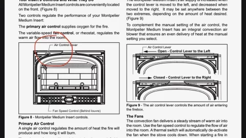

What year is your stove? A quick search for the Monty user manual shows a primary air c

Agonyzhou i downloaded your owners manual out of curiosity and as from what i gathered your air control is a dial like you said. From what i can make of manual it either is on a timer or is thermostaticaly controlled. If thermostatic i wouldnt think it would be to bad as it would b adjusting intake by temp. If just by time this could be bad because if your wood isnt primo in terms of moisture it might b cutting air too soon. I didnt read through the entire manual so it might state what it actually is. In any case i would get some known dry wood or bio blocks for that matter. I wouldnt even load it up just load it about the same as the loads you have been as a measure. If the stove gives you better heat output for a longer duration then the wood you have been using isnt quite ready.
The button control is a timer, I can even hear its ticking. There is no thermostaticaly controlled air. The only thermostaticaly thing is the blower's snapdisk.
They have the same manual I have. For me I don't really want to control the stove as long as it give me heat; and most likely I need all the heat it can give. And technically ther is air control (the button) so it is just have a very narrow range of controllability. Safety of cause is of paramount importance, and since the only variable is the amount and type of fuel, I want to find out the safe threshold of overfire, and keep a margin from it. Obviously it depends on my draft and installation so I don't think they can give me a straight answer. It may very well be I cannot over fire this stove with reasonable fuel, who knows?

I skimmed through the Monty 2 manual as well and apparently VC thinks the stove doesn’t need a primary air control. Their suggestion is to learn how much fuel to add for the given amount of heat desired. Hmmm.
