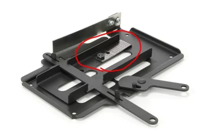

One thing I did notice is there's a small bimetallic strip on the side of the primary air control. It looks like it's designed to lift the air restrictor to introduce more air the hotter the stove gets, which seems awfully backwards to me? I've noticed that when my low-setting burns runaway, that device is fully engaged. But when the burns are more in control, it's either not engaged or only partially. This seems to explain the balancing act I feel like I need to do to keep this stove under control. It's only held on with a single nut, so I'm considering trying a burn with it removed. The primary air on low still wouldn't fully close with that gone, so I shouldn't risk smothering the fire. Here's a picture of what I'm talking about:

My stove has a bimetallic thermostat controlling the primary (only) air - if it opens up more in your system when the stove gets hotter, it's mounted backwards... It should do the opposite.

To be clear, this isn't the main bimetallic strip used for the automatic air control. That one does it job of slowly closing the air off as the stove gets hotter following startup. In the picture above, that's the large strip in the rear. It pushes the air restrictor plate forward as the stove heats up.
What I'm referring to is an additional bimetallic strip installed on top of the air restrictor plate, which lifts the plate slightly the hotter the stove gets, introducing more air. Seems like an odd inclusion in the design

So I decided I'd give it a shot removing that piece, figured it couldn't hurt. It came off really easy with just a single nut holding it on.
First impression after firing it up yesterday is that this stove is SO much more well behaved and controllable now. I was very easily able to dial in a cruising burn with my thermometer reading mid 400s. The temperature and burn rate are significantly more consistent now as time goes on, no more swings up and down, just a slow drop in temp as things burn down. I haven't tried this with a large load of wood yet, but I still had room to drop the air lower so I'm feeling pretty confident about it. Gonna test a longer burn tonight and I'll report back.
This said, I'm not going to recommend anyone else start modifying their stoves. There could certainly be implications for efficiency, warranty, etc. But you can look at my experience and make your own decision.

I just did a burn with the box about 1/3rd full and had visible flames for 3.5 hours. Consistent flue temps in the mid to upper 400s, though mine sits a little low on the flue so it does read higher. I've got a big pile of coals left that'll provide heat for a few more hours. I'm calling this problem solved.
