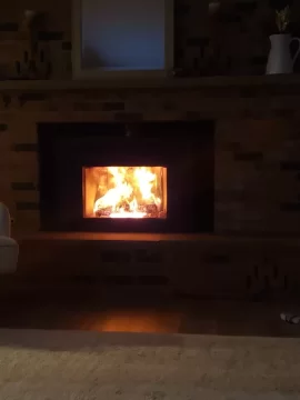

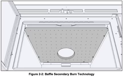

DrDieter
Sep 17, 2023
1
Lake Villa, IL
We got our Flair 34 installed last week. After a few small break in fires, I've had a couple medium sized (with the windows open) and would say that the performance has been outstanding. We 10+ acres of forest and a ton of ash, burr oak, and cherry that I like to burn. Our masonry fireplace is really large (32×48") so we wanted a large unit to fill the hole. I din't want a catalytic unit and I was sure that the large Lopi was what I would buy. Our fireplace store recommended looking at this one for our space. I knew of supreme from my research over the two years, but never really considered the stainless box instead of 1/4" steel or cast iron. The larger viewing area and match to our fireplace were the sellers for my wife. I was skeptical, but the soapstone made me feel a bit better. The controller seems to work really well, feeding extra air to get it going and then transferring control to the other air control once the box is up to temp. The baffle is different than the tubes in most and I do like that it is easy to remove to do a chimney sweep in the future. The glass has stayed really clean. Price was less than the Lopi by around a grand but wasn't the driver. Even though the door and face are well made and look nice, if Ambiance offered a 1/4 or 5/16 steel face/door, I would probably upgrade to that just because that's my bias of what a wood stove looks like. My first impression is that it will be a great insert. Overall the functions are really well thought out and a little different than most others.
