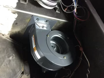

so far i love this stove great heat output!! my blower motor that pushes the air into the room went out last night, it looks like the shaft is bent on it somehow!! so going to local electric shop see if they can get parts for them, otherwise an oem motor on ebay is 200 bucks for it. its the fasco 80472. Anyone having one lay around? also the board is really hard to get the stove going its like the on button doesnt work all the time wich isnt that big of deal i normally just leave it running. Otherwise love the stove!

got a motor from local shop for 120 tax and everything. thought it was a good deal the thing is so quiet and really blows!! whats everyones favorite settings here? i notice if i set the thing to auto sometime the exhaust fan speeds up and slows down alot. so i like the manual not sure if its hard on blower going up and down frequently.

No kidding? Whats the numbers on it???? got any part numbers and names etc etc?
ill have to look its so quiet i can barely hear it run!! i believe the motor was rated for half of what the original was for in rpm wise but it blows just as hard if not harder than my stock one!!
Yes, Please find out the info on the motor PLEASE
Here's a picture of the motor from earlier I'll take side panel off maybe tomorrow and get shots of the sticker! Trying some different settings and hitting it with temp gun. A lot of post I see people are running draft fans at 9? Just curious
