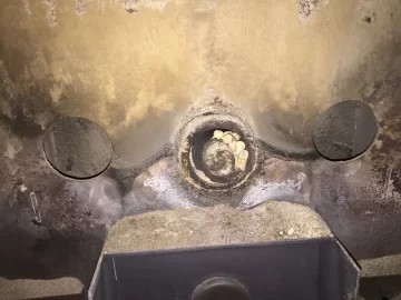

Hey, did we tell ya about getting the electrical KNOCK-OUTS for behind the fancy brick fiberboard? Get them if we didnt tell ya. they're 1-1/2 conduit knock-out plugs. Made of metal (obvisouly..lol) plug those round holes behind the fiberboard. It'll help scavenge more heat.

I have the cab50 as well I love that stove.. But this stove is great to!! I'm going to check those holes your talking about.. What's the idea behind plugging them?
Longer flame travel equals more heat transfer...... The right one (facing the firebox) needs covered more than the left one. It's (right) almost in line with the CA fan channel. Myself, I'd prefer seeing the right hole stamped directly in line with the draft channel to make it easier to vacuum the ash out.

So popped the little shield thing off are these the holes your talking about covering?

Anything particular to cleaning it other than vacuum inside out pull up the trap door in back and suck it all out back there?
Yup, plug those holes. Clean it good! If you got a leaf vacuum, suck it out!! Some of us get anal and clean it inside and out. Once you get a leaf vacuum on it, you can let it idle, and use an air compressor to blow it out and get bascially NO ash inside the house. Then it'll run even better i bet. haha.
In the pics ya posted, notice the ash and soot tracks leading to the holes?...thats where some of your heat is going...RIGHT out through the holes and up the pipe, Rather than being scavenged by the heat exchanger setup.. Plug em! Both of em if ya want! As flip said, the right one is the most important, however most of us did both of them. It'll help! ANd....like i said numerous times now, go buy a leaf vacuum....you can use it on both pellet stoves, and your friends stoves. lol Trust me, its worth it!!!

goto hardware store, and buy yourself some 1-1/2" electrical knockout plugs. they fit GREAT! Then install yoru backboard and fire it up!

So once those big holes are stuck shut its forced to go out the little ones at the top?
Exactly. The more you can force the flame and air to go out through the holes on top, the better heat scavenging you get.
