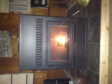

I did notice a light white haze on glass after about an hour of burning. I only burned about 1/4 of a bag, for temps outside we're in 50's. I was impressed with my 55-TRPAH. Andy & Mike are a big help & great to deal with.
Oh yeah here's a pic of the first burn
