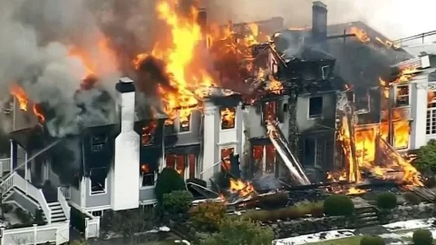

this could happen
[Hearth.com] Another CEMI Concept II insert

Lots of products have been unsafe from the start through the years. At the time they were making inserts like this they though doing it that way was fine. But it didn't take long for problems to start showing up. That is why code was changed making it illegal to install inserts without atleast a direct connection.
There are many many ways that a chimney fire can turn into a structure fire. And with an insert just slid into the fireplace the chimney fire can be extremely intense. That makes those risks higher.
