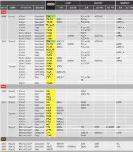

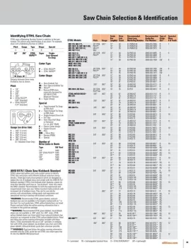

    Pitch = the distance between the drive links divided by 2 & hast to match the drive saw sprocket & nose sprocket on the bar
    Example : 1/4" , 3/8 Picco , .325, .375(3/8), & .404
    Gauge = thickness of the drive link & has to match the grove in the bar
    Example : .043, .050, .058, .063
    When buying chain; Match the bar pitch, gauge & number of drive links.
    Some 20" saws have 70 DL (drive links) some 20" saws have 72 DL.
    Saws having the same Bar length , Pitch & Gauge may have a different number of DLs.
    Picco - (Stihl) & low profile - (Oregon) chains , the teeth & DLs are lower (shorter) & have to match the drive & bar sprockets.
    Know the pitch, gauge & drive links, of your saw & you can go to a saw shop & have a new chain made, or buy off the shelf at many hardware stores. The info is usually on the box.
    Here is a Stihl saw chain link that helps understand some the differences.
    http://www.stihlusa.com/chainsaws/types.html#RSLFK
    & a chart for Stihl chain Identifyiers
