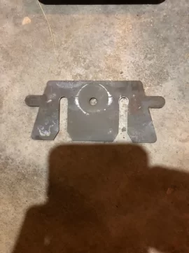

Thanks for the reply but where am I looking for the plate? Under the firebrick in the firebox? I’m not finding a thing.
Front of the firebox by the door, center. You will feel two bolts, may need a mirror to help you locate them.
Hard to say. Loosen the bolts, and see if you can pull the plate up. It will slide up if the bolts are loose.

All above the firebrick. Take off the 2 bolts, remove everything that comes loose, and take pictures of what you have. You should have 2 bolts, a small metal piece, the restrictor plate, and the large metal piece.

Just got the chance to look at it, is this the restrictive plate i need?
