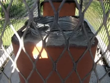

Here you go BB, It looks like it is cemented in place, so I 'll need to make up any differnce below. What do you think about a block off plate? Thanks again.

Uh oh. Is that liner mortored into the flue tiles?
Rakuz, just out of curiosity, what does your second flue get used for? Also, if the SS cage is fixed (cemented in) how do you gain access to the flue for maintenance and repairs?

Sesond flue is for the gas water heater and furnace. The top of the SS cage comes off w/ screws.

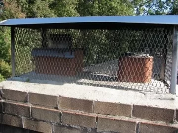

Gothcha BG, stove is welded, looks like a great job! I guess my question is this? If my liner is mortarted in at the peak, ( please see pic) would I gain that much from adding a block off plate?

If it is an exterior chimney, yes. You'd be surprised how much heat cold masonry can suck out of a stove.
Given that the piece of sheet metal is eight or nine bucks in the duct work section of Lowe's and making and installing the block off plate is at worst a thirty minute job, yes it is worth it.

Edit: Curious. Every time I look at the pic of the top of that liner I get the feeling I am looking at an 8" liner?
I have to say it is an odd way to finish a flue liner install. BB what size clay liner is that if you think the SS liner is 8"? 9x9?
I'm guessing it is an 8"x8" or 8.5" x 8.5" OD clay tile. Same thing we had in our house for the defunct oil furnace.
Just had to ask. May be the angle. May be the old eyes. Sucker just looks bigger than six inch.
Compare the flue width to the width of the chimney bricks which would be about 7.625" if standard brick.
Ok guys, I'm ready to start a template for a block off plate, but I do have a question. My SS liner is sealed in at the top of the flue w/ cement. (as you can see in previous pics) Will this create any kind of problems with the added addition of a block off plate down below? Any draft or dead air space issues? Just curious.
Yep both are issues. Good ones. The dead airspace holds heat and helps increase draft in the liner.
Get that thing in there.
rakuz66 said:
My SS liner is sealed in at the top of the flue w/ cement. Will this create any kind of problems...
Yeah, shouldn't the liner be free to move up and down to allow for expansion when it gets hot?
