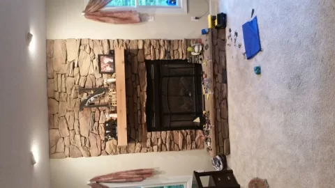

Hello everyone i have been surfing around here for a couple of years now but after last year outrageous electric bills im finally ready. I built my house 11 years ago and put a pre fab in . I have never burned wood because i was scared to burn anything in that tin can. So it should be in good shape. I have been to a few fireplace dealers and they are set to come out and look and give me some prices on a regular wood burning insert. So is it safe to where me and my family can sleep soundly at night. The model is a white mountain vfsr-24-3. I tried to get a hold of white mountain but there is no contact number just an email. I live in the middle of the woods so firewood is not a problem. I still plan on leaving the thermostat set at 60 but i plan on burning the majority of the time. Thank you
Are you sure that is the model of your fireplace? When googling I find this: (broken link removed to http://www.whitemountainhearth.com/assets/WMH/manuals/ArchiveManuals/VFS%28R,V%29-%2816,18,24,30%29-3;%20VFSM-%2818,24,30%29-3.pdf)
It looks more like a gas burner that can be installed in a fireplace than the fireplace itself. Can you post some pics?
I think you right , would it be labeled on the fireplace

In general no you cant put an insert in a zeroclearance unit unless both the manufacturer of the zc unit and the insert agree that it is ok. And there are very few zc manufacturers that are ok with it

Check for a label; could be in the front at the bottom. Also take a look what kind of pipe you have and what diameter. Since you say you built the house: Any way you have a manual or maybe the installer would still know?
Ok i had my installer come out and take a look. He said it it a fmi / ihp model pre fab, zc . He is going to get back to me in a few days with an exact price. They are going to give me a price for a regency i2400 and a Hampton hi300. He said the stove liner and new cap is going to be roughly 3200 -3800 installed. Does this seem fair and safe ?
