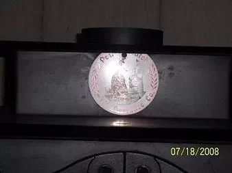

Any possibility of getting a photo posted for the stove? Sounds like it may be a nice old one. I'd like to see it.
I'll have a pic up tonight. Looks a lot like the Master Choice Photo on the wiki page, maybe a little more basic.
Pictures as requested!!
  • [Hearth.com] Another one of those "what should I do questions"

I suggest looking that stove over reallll well. Inside & out, for cracks, warpage etc.
Its obviously been repainted, and unless you look it over good, you will never be able to tell if it was over fired from the usual white markings. But cracks & warpage will tell a story.
The brother in law and me could not find a crack. Hate to admit it but the paint job was from me.
HAHA, I saw that side photos, before you took it off ;)
Alot of can strokes a lil too far from the surface, "dry sprayed".
Before you painted it, did it have any white areas as in on the doors inner &/or outer, the top or side?
Sure sign of ever firing. No warpage?
If not, lookls like shes in good shape, but you will burn more wood in the older stove.
Hey! I put it back up. :red: I looked over before that expert paint job :roll: and could not see any white anywhere and its straight no warps no cracks. Of course I imagine firing it up might change that.
Thanks beagler. Nice stove, she looks good to go.
