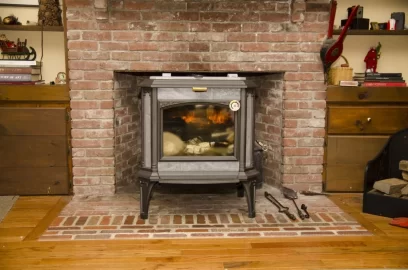

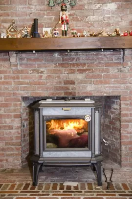

Here is my proud Progress install. I extended the hearth in anticipation of needing more front clearance, it turned out my old clearance would have been fine - oh well. It passed inspection, too!

That looks beautiful fire_man, thanks for posting. I'm looking forward to your review.

Tony, is that an ashlip I spy??!?! It looks awesome!!! Are they in yet?
Hollow Hill:
Good Catch, I got the first ashlip, its a prototype. Turns out I was directly responsible for it's design due to earlier conversation of mine with WS to reduce hearth clearance reqirements. It even has my initials stamped in it! I call it "the Tony lip".
