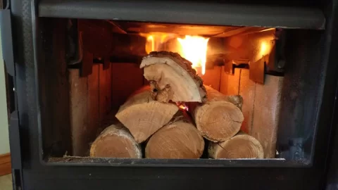

You can see it in the back here; The baffle is touching the brick rail in the center by where the holes run to the back, and has a gap on either side between it and the rail. So some secondary air is leaking there instead of all of it going to the holes in the baffle. I'm not getting a new baffle, unless they send a thicker one. What would be the point if it's just going to warp again? I'll either bend mine back flat, or seal the gap with interam and/or flat woven gasket.
Or possibly heat it up before bending it back flat..
Not sure if begreen's did that, or @Hogwildz or if it's just a Super box issue.
Oops, forgot pic.
[Hearth.com] Another "Which new stove to buy?"
The baffles warp some. Depending how hard you use the stove, will warp more, but I have never seen it affect performance.
The baffles are same thickness as they always were, just the added port holes on the bottom.
The rear of the baffle also has secondary ports under the angle pc on the bottom rear. Secondary in back is as designed, and not from leakage.
It may crack trying to bend it back or attempting to flatten it again. I've just burned and let it do what it does, which is the job intended without issues.
It's more of a sag than a warp. Our stovetop gets up to 650-700F with almost every burn, except in milder weather. So far baffle sag has been minimal after 10 yrs., maybe 1/8" or 3/16"?

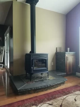

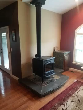

Just an update.. I finally found a stove. Jotul F55. I found a dealer with a couple in stock for a decent price I think. 2100.00 I'm going to pick it up next weekend. Its 4 hours away but 550.00 cheaper than I can get anyone to give me a price local. I'm pretty excited. Problem is it's about 50 miles from Gattlinburg TN. The wife wants to just make a little vacation out of this weekend. So the savings on the stove will be obliterated .. haha good times.
Better make sure that they hold the stove for you. Call before you leave to verify it is still at the store.
That looks super. The hearth came out great.
