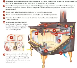

My Lopi Liberty draws primary air from beneath the stove and feeds it into a horizontal manifold across the bottom front of the firebox (some folks like to call this a "doghouse"). From there, some of that air does, indeed go to feed the airwash system, but the rest of it flows out through a centered port in the back wall of that manifold...directly into the coal bed. Rick

There are several steel stoves that have a boost manifold front, bottom and center. The Englander 30, Lopi Liberty, Pacific Energy Summit (or T6) are a few examples. The majority of the air will still be used for the airwash, but a portion is directed at the front base of the fire. Another option would be to get a cat stove that has a thermostat. This will open up and feed the fire more air if the room is cooling down. Blaze King stoves would be worth a look if you like this option.
