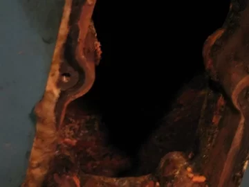

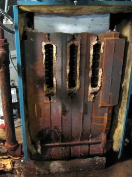

so I have a burnham oil burner v-14a installed 19 yrs ago. Two years ago I was told it was in rough shape and had to be rebuilt including the fire box. Over the last weekend I went to clean it for the season (a first by myself) Cleaned out the flues with a brush and vacumm. removed the burner and the mounting plate insulation crumbled apart. There was so much build up in the fire box that it was right up to the fire tube. I vacummed out carefully as I read the note to be care full of the chamber liner, well there wasn't any liner left in the system as it was all rust bits and junk. It has some major issues and I was told it was best to replace it by an oil tech that I think I would trust. Heres what it will need if it could be repaired:
Chamber liner.... completely gone and inside of chamber is rusted up fairly well, does the system need to be cracked open to fit this in? from the measurements and blown out diagram it doesn't look like this is something that "fits"in??? would it even be possible to crack a unit this old that is rusty/ has seen some water...
Burner mounting plate insulation
target wall insualtion is preety much all cracked up but is still standing.
air tube gasket
It is fairly rusty and beat looking and I am recieving a qoute from the tech that looked at it for a new system (he said roughly $6500+) Ineed the chimney lined too
I also got a qoute from a friend that is a plumber for abot $5800
Just wondering is there a repair that can be made? and roughly a ball park figure? I know it may not last long but I also know there is no way I can come up with that kind of $

The target wall will fit through the hole behind the burner plate. It stands in the back with tabs that go between the back section. There's a blanket that lays on the floor of the chamber and a piece with a hole that goes behind the burner plate. Everything is a tight fit.
tbs,
thanks for your response, I see where they go and understand the wall and burner insulation but does the unit need to be opened to get the u shaped liner "blanket" in or can it just fit throught the small opening?
Has the boiler been checked for leaks? If it has no leaks and the flue passages are still ok, then I would repair it for now it should last. The combustion chamber liner kit will fit through that opening, there is no need to split the boiler. The target wall will go in then the kaowool blanket goes in and you unfold it. They usually give you waterglass that you put down to help seal it up and harden when it is first fired. Then the front section of refractory goes in, then the burner plate with a bead of high temp silicone. Then the burner flange gasket which is not usually in the kit. It not too hard to do just make sure you clean off all loose soot/rust and vacume good before installing. Note that kaowool and ceramic board is very bad for your lungs make sure you wear a dust mask.
