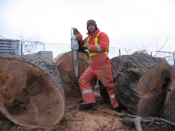

    I had to move similar sized pcs of red oak last winter. Either sharpen or buy yourself a rip cut chain for your saw if you don't want to manually split as suggested above. Chop the rounds into managable chunks and haul it away.
    that's a 20" bar on my 361, this tree was BIG
