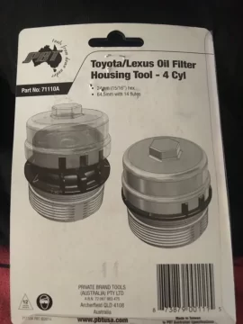

Anyone ever change a Toyota car oil filter with that plastic housing?
Don2222
Feb 1, 2010
9,331
Salem NH
Hello
These new paper oil filter is like the old one I had on the House oil tank! However the housing is all plastic and it may be on too tight!
I have not tried it yet, there are many tools for it but I got the OEM tool part # 71110A $27.95 for the chance it may work? Anyone have a little experience with this?
Here is a good video on how troublesome it can be!

Hello
Well I was Successful !! To tell you the truth, I used my air wrench and 24 MM impact socket. I set it to loosen and put it it on to the oil filter fully. Pulled the trigger 2-3 times before it started to loosen, then it loosened right up!
If you do not have the OEM Toyota Steel cap socket and an air wrench then forget it!!
When I put it back, I used a regular wrench and just did it hand tight. :)
The old filter was very dirty!
All Done!

I think the first oil filter socket I got was from Toyota. Yes it's the one you show with those cutouts in it. It went on so far, those teeth it hit the spring clip mounted on the housing. You can see it at the bottom left side of that video. That clip jams in the teeth of the socket, preventing it from rotating. You may have been stuck on this and didn't know it?
So I used another filter socket I had, that was not as deep. I think it's a standard socket for Honda / Toyota you can get in any store. I've never figured out what that clip and those teeth in the socket was for. Just doesn't work.
Putting it back on, the plastic cap threads in a ways. Then the "O" ring on the cap goes into the housing, making it much harder to turn. A few more turns and the caps shoulder bottoms out on the housing So It comes to a abrupt stop. When it stops no more pressure is needed.
