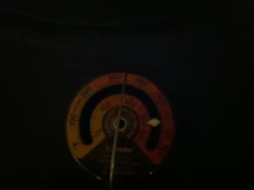

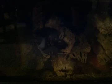

Here is my Blaze King Ashford on med-high.
Just so you can get an idea of how they pull off those long burn times.

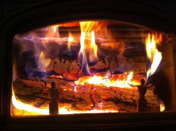

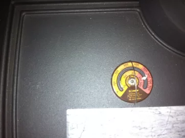

Here is the Cape Cod also running at med-high with nearly the same stovetop temps. These are both convection top stoves running in the same house, with the same wood.
A few big differences are of course the fire view, and the intense heat that comes from the glass. I'm sure everyone thinks that they have hot glass, but this is super intense! The floor is too hot to stand on with bare feet!
It's pretty obvious why the BK is so easy on the wood.

Thanks, Webby! Very interesting. The BK is incredibly boring. Would you say that the stove temperature on the BK is very hot right above the combustor and then cools down dramatically over the rest of the stove, while the Cape Cod is pretty hot on all surfaces?
