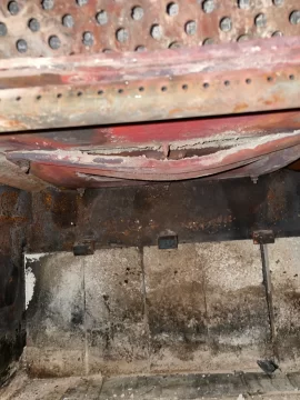

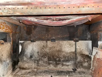

My goodness. I knew this part was a weak point! I'm not happy at all with this stove. Mine wrapped in the front of this , bypass door frame. I bought the bypass door frame kit, 051-221/p . It should have been made thicker , maybe another 1/4" thicker. Imo.
So I have the kit. Doesn't come with the gasket that goes on the top of the frame for the door but a gasket that you need to stick to the door itself. They also sent 2 reinforcement bars to bolt up with the front and back of the frame. It's already bent from having the bolts welded to it. How thick you might ask? 3/32 of an inch. This craps going to melt off. Weak attempt at a manufacturing weak point.
Pics of what's in the kit. I replaced This stove with a blazeking princess. Muly house is warmer eventhough the stove is "smaller" than the regency f3500. It's also colder now than before.

I have had my 5200 for only 3 seasons and it’s having the same issue.
Weak point for sure
Has anyone had any luck fixing it ?
