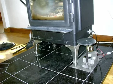

I have built an automatic air control. You need more than just a timer, mine has a probe in the flue and a digital timer( not shown in pic).
The way it works is when the flue temp reaches 875::Fthe damper motor is actuated, for about 3 sec, this will close the air about 1/4.
The timer waits for 20 sec, if the flue temp is still above 875::Fthe damper motor will be actuated again and close the air another 1/4.
Cycle will continue until flue is below 875::F.
The system works quite well, if you load on a hot coal bed you will get some overshoot, but the flue temp will usually be under 1000::F.
I recently made a video of my system in action, when I get a chance I will post it. [Hearth.com] anyone thought of this
