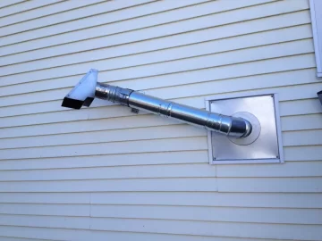

When you say sooting? No black tips? color orange yellow or white yellow? I have soot on the back of right baffle panel and sides and top of firebox. Is the damper supposed to be wide open? Others have mentioned this was one reason I wasn't getting the heat I wanted and I had thought my fire on high when I do run on high sometimes I wasn't getting enough heat. I had the feed gate closed and damper almost closed. I have since opened the damper all the way and the feed adjusted about half or a little less and runs beautifully on medium but still had some soot or black flyaway ash on the sides. Burning MWP from TSC. 80/20 blend.The CAB-50 in the store just fired up, running it on low. Flames might be 1/2 way up the glass and a little lazy but no sooting inside the firebox. I have never had to mess with the damper under the ashpan on any Heatilator but we are just above sea level here. It is vented with 4" diameter consisting of an adapter, tee, 6' vertical, 90 and 24" horizontal with a cap. Glass gets slightly covered after 6 days.
Eric

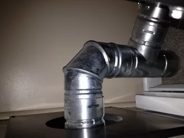

I'm thinking it's the pellets. I have the cleanout t, 1 foot straight up, 90 to 1 ft straight out, 90 out angled to the left because of clearances to window and 2 ft of straight angled up about 1ft to ft and half and 45 then capped. 3 inchI have NEVER adjusted a damper on a Heatilator. They are born with the damper wide open.
Sooting as in black soot inside the firebox. Ash should not be black.
How is it vented?
If it is not a venting issue I would look at the pellets
Eric

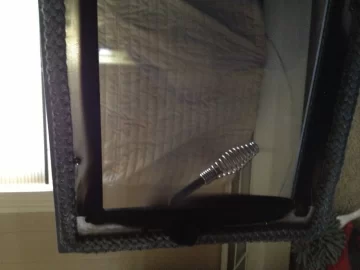

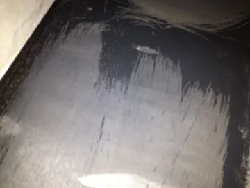

Also here's a few pics that you can see. If its just the pellets co but if there is some adjustment I can do I'd like to know. View attachment 91881 View attachment 91882
Record it while its running and let us see! I hear you there. I'm going to clean the venting today. There is some ash buildup and we had a lot of wind the last few days. I remember reading that can happen.In my second year, I've run probably 150 total bags with 125 being the same brand. I get those exact looks, black on door rarely happens (in exact spot and looks exactly the same) and ash on baffles (light gray dusting) consistently.
I really don't think you should be playing with the damper. It's factory set, the manual gives no hint of adjusting that I can find and once read (really can't recall where to cite) that we aren't supposed to mess with it.
I love the fact that you are so ferocious in posting about your cab50. Nice to have another since there appears very few of us post about them. But my opinion is you are over-thinking a lot of this. I'm for tinkering but I never know when I hit "good-enough" and cause more problems then I started with.
Given that, it's your stove. Do as you please.
I've meant for a week to video mine so we can compare, and I will once I have time to let it cool down and not so cold outside.
I've done the dolor bill test. And it is tight all all sides except closest to the latch. I've already removed the washer to make the door tighter. Here's a video. Pictures to follow of the venting.
Now I don't feel so bad because that is mine on high.The way I measure is that from the floor of the box to the top of the the pellet hole dropper is 6 inches.
I run mine med with probably 1/4 closed. Your video is what mine looks like on high right now. For what it's worth.
